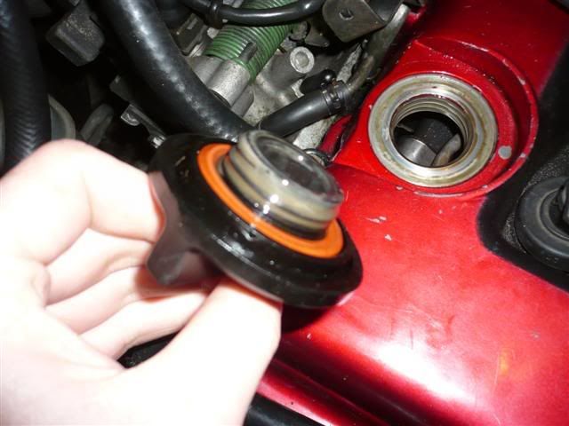

Next day, happened to check oil cap, and its milky as hell. Think shit, headgasket is gone.

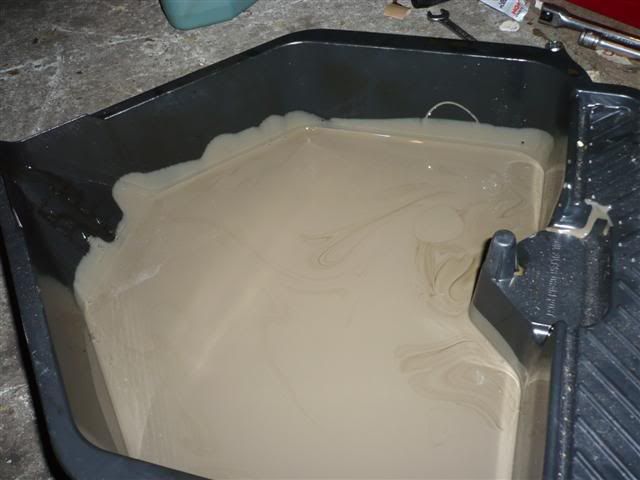

Drain the new oil back out, and its like light coloured mud.... Im sure its full of water.
So my question, I have I either have a cracked head (due to amount of water i think its more than a headgasket), or im wondering if a t28 turbo can crack and allow oil/water to mix inside it.

RS13, there is no need to pull the sump off to look at the crankcase... the colour of the oil shows me the whole motor is going to be that colour inside.
Its like a browny gray colour. Ill take a pic tomorrow.
The think I don't understand is how it mixed so fast.
Only other cause is that he left it outside with the cam covers off and the bonnets massive vents allowed a fair bit of water into the motor, which when i ran it for the longer time, heated up and mixed with the oil to make the milky shit.

Best idea to get watery oil shit out?
slighty_sykotic
Posts: 1749
Postby matt dunn » Fri May 23, 2008 8:03 pm
slighty_sykotic wrote:Best idea to get watery oil sh*t out?
Get it hot and do an oil change,not just up to temp but run it till the fan comes on,
Then run it on the new oil until the fan comes on again, stop the car, remove the tappet cover and let it sit overnight in a dry garage.
The water will evaporate.
