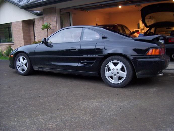

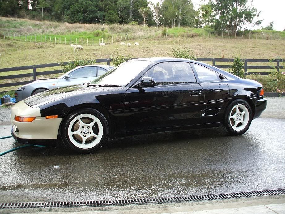

Boosted_162 wrote: I run 205/50/15s and 225/50/15s on mine.
Well in that case I will buy some 225/50/15 for the back and swap the back tires to the front wheels.
http://i186.photobucket.com/albums/x281 ... 2005.5.jpg
Is this photo showing that setup?
GDII
Posts: 1645
Postby Boosted_162 » Thu Jul 03, 2008 7:33 pm
Nah back then it had 195/55/15 on the front. But was still 225/50/15 on the rear.
Thats with 205s on the front. Man i hate that white bumper :( :lol:
