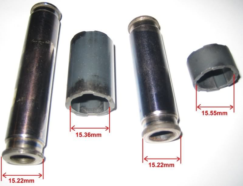

Postby pc » Wed Aug 27, 2008 7:11 pm
KinLoud wrote:2 - Are the pads thin at opposite ends?
2 is caused by the caliper cocking under braking load due to worn sliders or slider pins.
Looks about right, wear is probably the problem. The worn sliders have the following measurements, but I can't find the measurements that the sliders are ment to be new... anyone know?
I found in the Haynes manual yesterday that it says to use a silicone-based grease. but there are no measurements or tolerances.

Postby Bumpy » Wed Aug 27, 2008 7:27 pm
So if the sliders are buggered? Can I get new ones and rebuild them?
