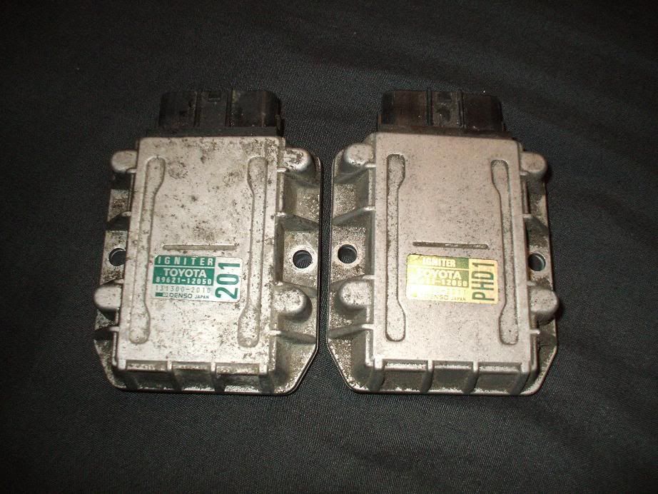

Just one thing i remembered. My original ignitor had a slightly different part number. Could that be it? Both other ignitors i had tried were GT4/3SGTE ones. Part numbers are 1 off.

What year is your GT4,
Part # should either be 89621-12010 for production dates before 9108 or 89621-12050 after that.
Postby Boosted_162 » Mon Aug 18, 2008 11:32 pm
Its a 1992. All my igniters are 89621-12050 but the one that came in the car has PHD1 written on it in big letters, and my other 2 have 201 on it. And the Denso numbers are different... 131300-2010 compared to 131300-2011.
