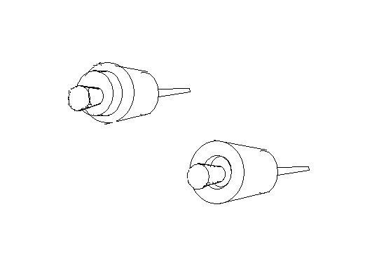

Postby drift-monkey » Sun Sep 28, 2008 9:54 pm
just do the opposite to making more lock, i machined a few mil of the rack ends sotd slide insede the steering rack so if u just machined the rack ends opposite
like this...
