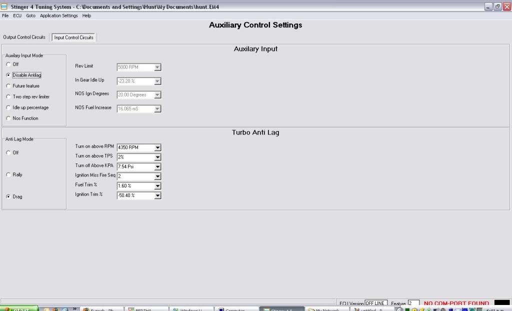

I have drag mode antilag in my car with the Stinger but only set up so it's off above 70% throttle and above 4,000rpm
With more practice I'd set it up so it ignores the TPS, turns on above 4,000rpm and ONLY turns off when above 5psi. That way you can burry your foot, hold it below 5psi - when you dump the clutch and the engine loads up, you'll instantly get more than 5psi so it turns off.....
yeh iv got that in my stinger too how do u set it up? from memory u can chnae the missfire and shit?

Postby cat007 » Fri Oct 17, 2008 6:43 pm
have a play - every car is different - mine isn't totally right for my car but it works
