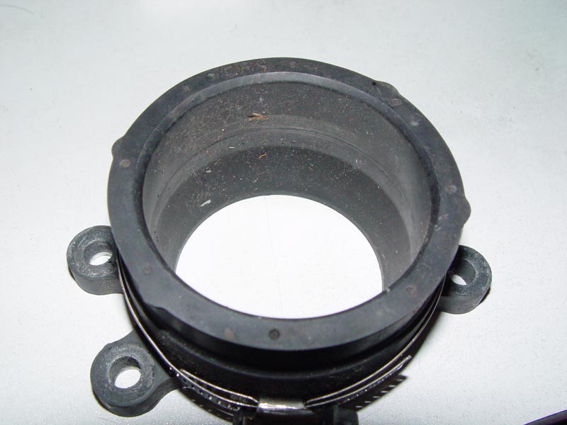

Hey I have a ST205 interface piece since I've put the ST205 motor into my SW20, if you want that piece gimme a yell :) It's a rubber piece. I'm sure I still have it around.

Awesome. Would you possibly be able to take a picture of it? Im just trying to get my head around it, and its not coming out right :lol: :lol:

Postby Akane » Tue Nov 04, 2008 2:21 pm
Postby Boosted_162 » Tue Nov 04, 2008 8:20 pm
Akane wrote:http://lol.co.nz/temp/st205_throttle_interface.jpg
clicky
Now thats what i want. How much you want for it?? Looks like all i need to do is fab up a new throttle cable bracket. Or might try use a ST205 somehow.
