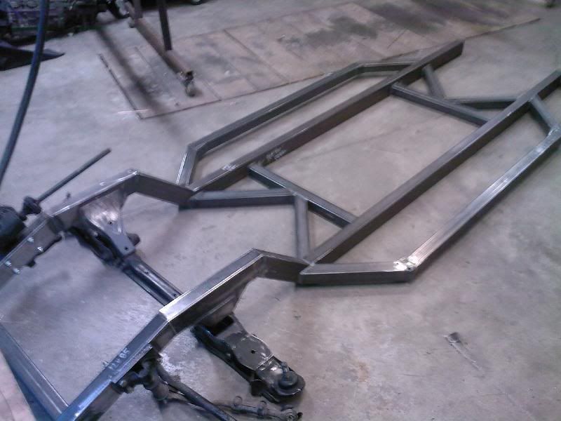

Postby evil_si » Thu Nov 06, 2008 7:27 am
best bet is go and find yourself a certifier and talk the idea thru with them,
they will soon tell you what you need to know and what you cant do,
i agreee with postfach you would be better ditching the original subframes and just using what you have to, making arms etc
for my current project im building a chassis from scratch, im lucky with it being a ute the cab comes off, but there is no way im using the original subframes from any of the components i intend to run
