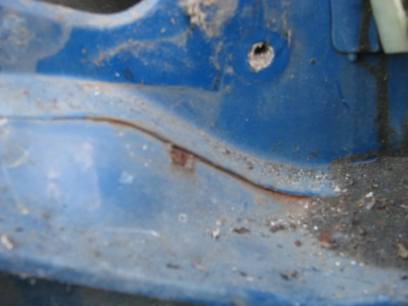

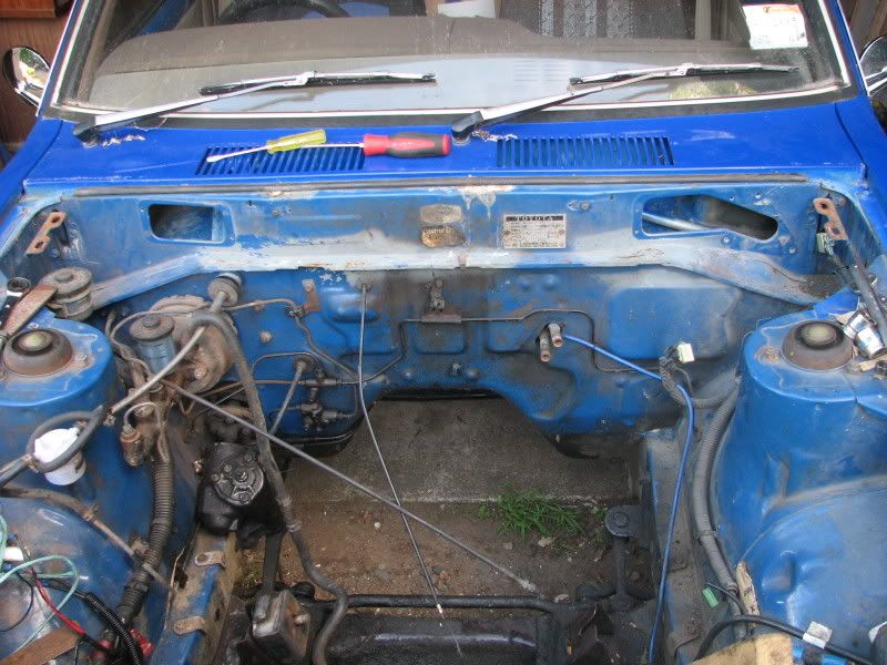

my corola has a little bit of rust just starting along the lip on the fierwall. how do i stop the rust from spreading atleast? dont have a welder so cant realy cut and replace..
pics of what im talking about
there has been an attempt made at removing it in the past as you can see but has faild..

Personally I have used a product called Blackguard, very simple and easy to use & from what I have experianced provides good results.
Website is http://www.tergo.co.nz/Tech%20Data/HTML/blackguard.htm
Have used it on the KE to prevent rust spreading, this is what it looks like when brushed on

Postby rollaholic » Fri Jan 30, 2009 11:01 am
mate that rust is alot worse than it looks, you need to strip the shit back and fix it properly
or it will come back to kill your car

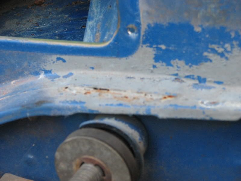

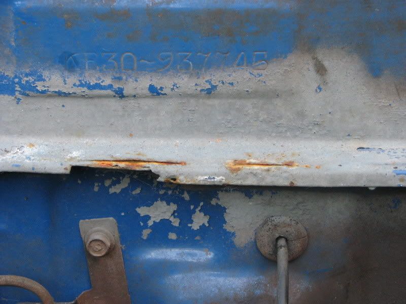

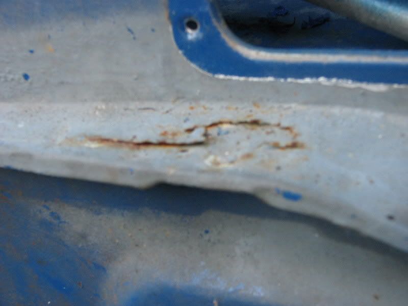

Postby 79rolla » Fri Jan 30, 2009 12:56 pm
just hd a scratch with a screw driver and wier brush.. its not too srioys altho i revailed a bunch more spots and sum big patches in the corners and some patches along where te rubber at the back is once i got it off,, i might just go buy some rust kill and coat the whole strip from the lip to just b4 it changes to bodywork paint.. if you get what i mean. can get pics if it will help..
