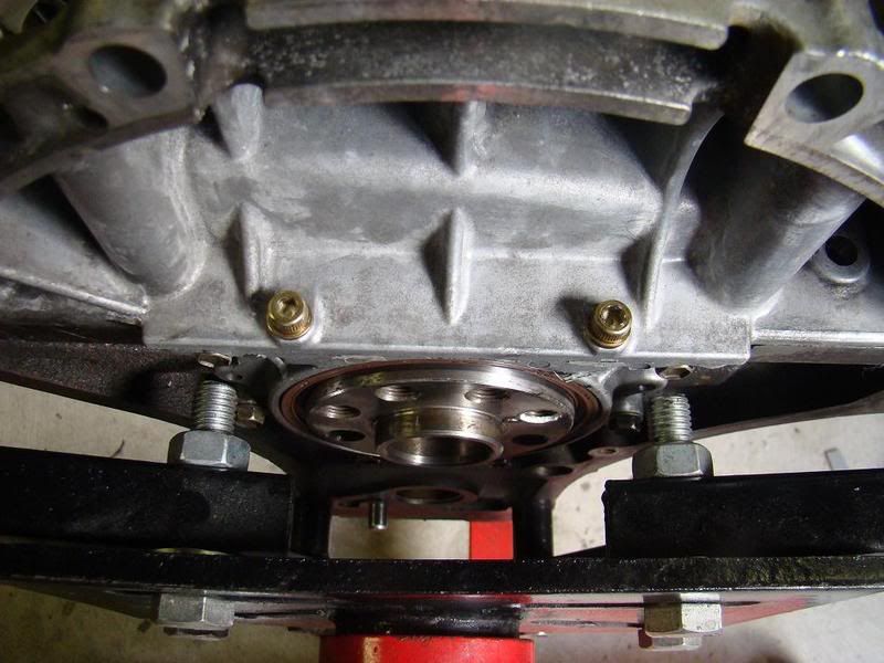

I've pulled the head off the motor. As I was stripping it I checked the P/S Pump, Water Pump, Idler Pulley, Harmonic Balancer, Camshaft Bearing's, and VVTi Pulleys. All seemed fine with no obvious damage. Bearings are all smooth and clean, no marks or scrapes. Slight discolouration in a few where the metal was darker than normal.
Once the head was off I was expecting to see something like bore damage, marks on the head from where the piston was knocking, but nothing obvious.
Turned the motor over and checked all the bores, they are mint, no scratches, marks, etc. All still have a light cross-hatching on them. Next I checked the pistons by rocking them in the bore, #1, #2, & #3 all didnt move that much, and were sitting central in the bore with an even space all around.
#4 on the other hand had a little play in it, and was sitting up against the front facing side of the bore with next to no gap on the front face, but on the rear of the bore had about a 1mm gap. The attached pictures should give you more of an idea...
Image Image Image Image Image Image
Last one is the most interesting and shows the piston sitting to one side. So what do you guys think? Bent Conrod or Gudgeon pin? Any comments would be appreciated!
