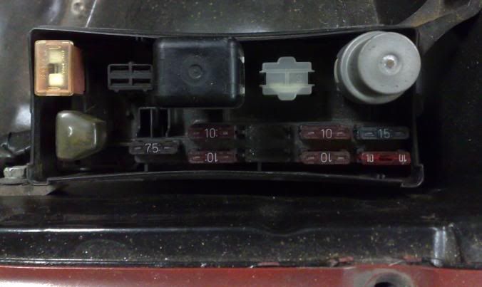

So, looking for a photo of....
AE85 Trueno underbonnet fusebox, without the cover on so I can see what relays are fitted, and what ratings the main fuses are,
and also if someone has one with the diagram on the lid,
a photo of that too.

Postby frost » Thu Apr 02, 2009 9:44 pm
are you also missing the relay to raise and lower the lights? its separate from the fuse box. also i think the switch on the dash is different
is that what your after? top of it was blank so no help there.

Postby matt dunn » Thu Apr 02, 2009 11:49 pm
frost wrote:are you also missing the relay to raise and lower the lights? its separate from the fuse box. also i think the switch on the dash is different
Exactly the pic you I am after.
I that pink coloured fuse in the corner a 30 or a 40 A,
and if you take the cover off where there is a relay missing beside it,
is there a shorting pin underneath to join to circuits together.
I actually found a good wiring manual on the net last night and may have it sorted now.
Postby frost » Sat Apr 04, 2009 11:20 pm
the pink one is 30a and yes shorting pin under the cover, though i've never tried it
Postby matt dunn » Sat Apr 04, 2009 11:49 pm
frost wrote:the pink one is 30a and yes shorting pin under the cover, though i've never tried it
Thats ok.
I can tell you then that the shorting pin and that fuse are for the Headlight retractor system.
Matt
