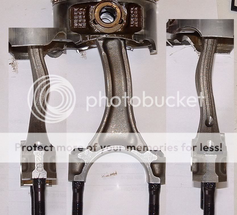

Oh I see, that explains why my number one conrod is now 4mm shorter than the rest after my 20 psi bosst spike, DOH

Flat topped 2JZGTE pistons with shot peened GT-T rods and ARP Bolts and a 5SFE Crank giving 9.5:1 compression and a 20psi boost spike on a MSE TD05 Hybrid = a conrod attempting to do Yoga as per this pic
