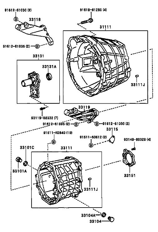

The J160 6MT does have a removable bellhousing but you will need a custom one made up to suit the 2JZ (refer pic below)

Postby matt dunn » Wed May 27, 2009 10:21 pm
Nice picture's but wrong.
the bellhousing does come off, your right, but it is also 1/2 the gearbox.
Take the bellhousing off and there are all the teeth and shafts falling out.
See in the second pic, showing the mid section of the box, there is no support for the shafts etc, so cannot use a normal type bellhousing.
