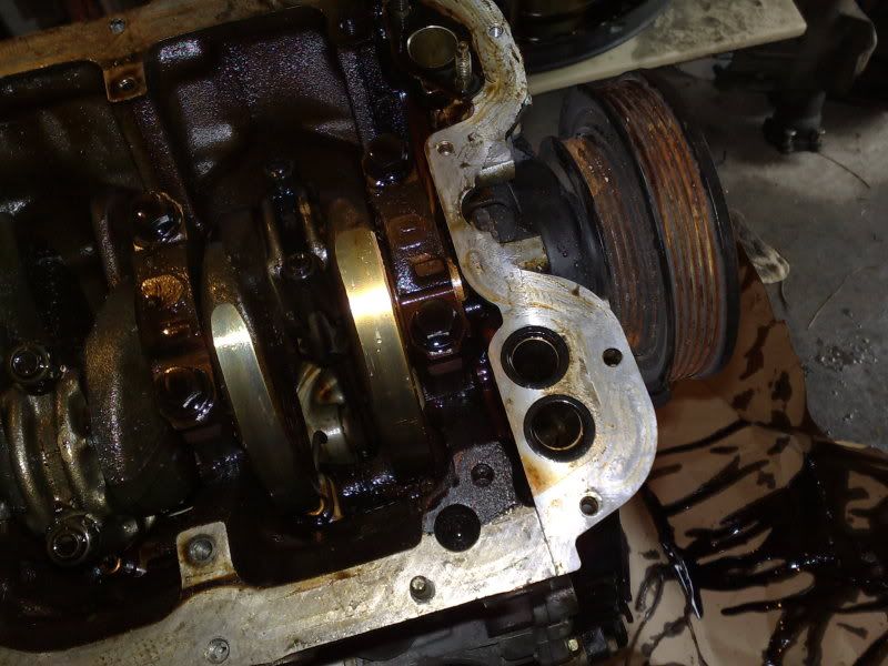

another thing i need to know... i took the sump off last night, im wanting to use a 2S sump and pick up. now the problem is the front cover oil filter feed/return cant be used. the plan is to use a oil filter relocation kit from the side of the block where the cooler is and plug up the feed/return on the front cover. is that ok?
OR should i loop them together(i thnk i can do this)

Postby strx7 » Thu Jun 11, 2009 6:47 pm
1 if for the pick up, one is for the pressure relief valve, you're going to need to FUNKY plumbing to get rid of the alloy piece of the sump
Postby frost » Thu Jun 11, 2009 9:41 pm
oh is there more to the alloy sump then just two holes feeding the oil filter? i'll have to investigate later.
the oil pickup is top center of picture.
the oil filter feed and return is side by side at corner of block.
i was thinking of just looping the two holes that feed the filter and run remote filter off the side of engine like gen2 style.

Postby strx7 » Fri Jun 12, 2009 3:25 pm
frost wrote:oh is there more to the alloy sump then just two holes feeding the oil filter? i'll have to investigate later.
Those 2 holes, one goes down to the oil filter, one comes back up, BUT the oil pressure relief valve is also in that piece of sump, not exactly sure how the plumbing goes but you need an external pressure regulator if you're using a 2S sump on it
