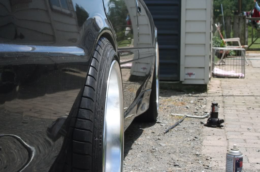

9" wide rims offset is +35 ( i have some 17 x 9s that are + 34s and these dont fit under the gaurds on the front with 235s on the front, if you put 225s on the front all will be fine )

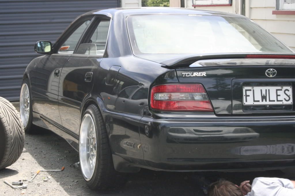

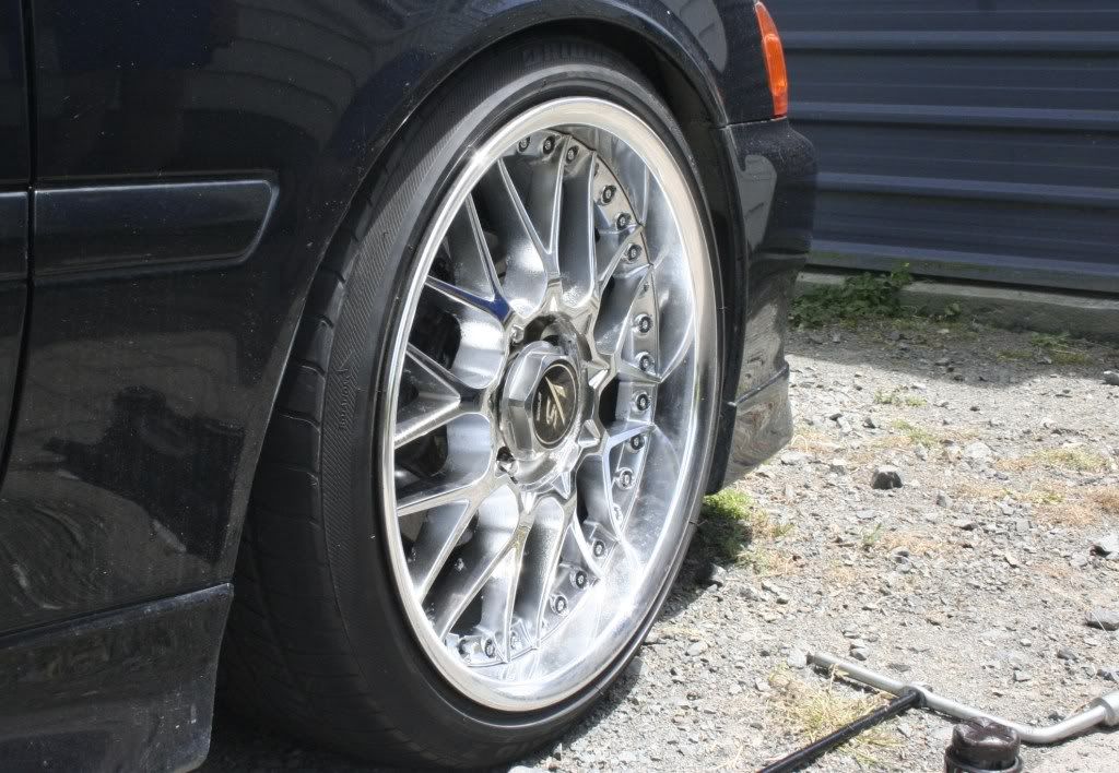

in all honest opinon 10" wide rims are just to big ( see pic ) , 9s or 9.5 on the rear would be fine
but it also comes down to what rim he is wanting or look hes going for, the dish look or the jdm drift look
so to sum it up + 34 would be ideal with a 9inch or 9.5 wide rim
this is a 10" wide rim with +25
this is a 9" rim with + 35 offset
