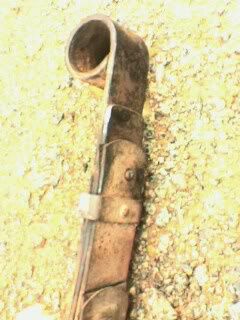

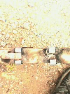

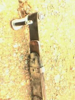

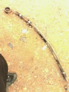

sweet as, iv got it sorted now
just cut the main leaf down from my parts car, and straitened out the clamps to get it in then bent them back after
