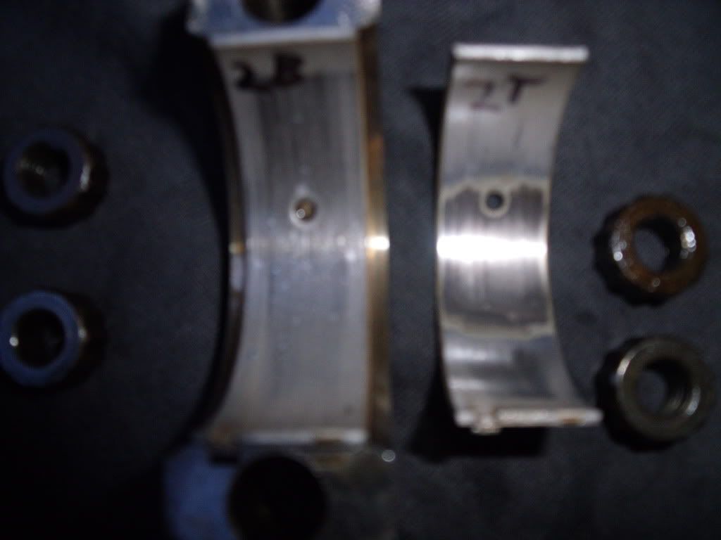

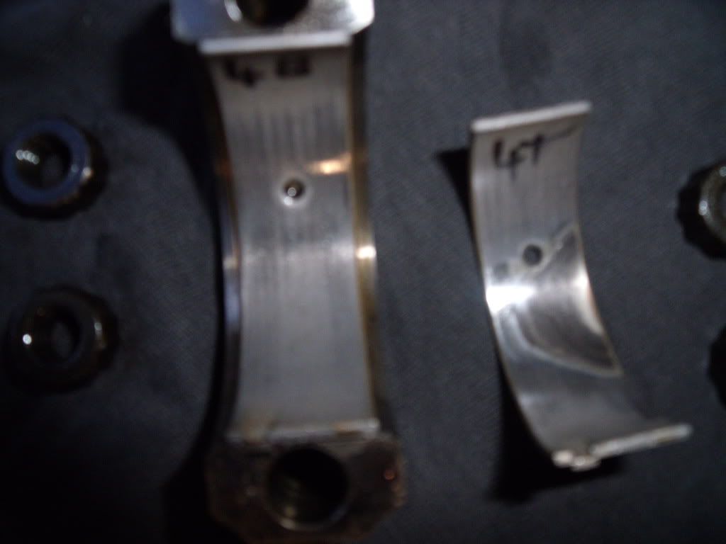

Postby d1 mule » Tue Oct 13, 2009 8:20 pm
got the bearings out look to have been hot and scuffs on them?? but in saying that i dont know what a run bearing looks like
