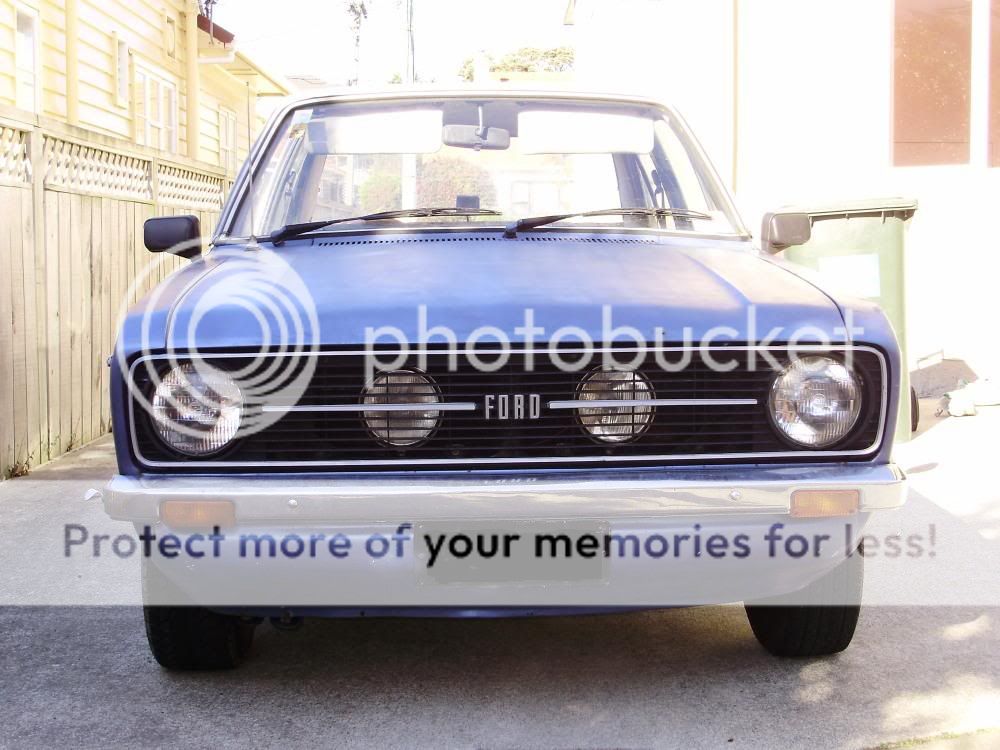

Postby jakesae101 » Sat Nov 21, 2009 8:37 pm
sorted i can have my "main beam lights" then and my fog lights i recon it will look cool this is what happens when i become money poor and time rich
EX. MK2 escort 4 door 1300cc
EX. AE101 trueno gt apex
jakesae101
Posts: 1178
Location: welly
Postby Mr. Mainstream » Sat Nov 21, 2009 10:03 pm
oh that looks choice jake, really good. i would have to mount mine externally due to them being slightly larger then those ones,

Postby jakesae101 » Sun Nov 22, 2009 8:42 am
Mr. Mainstream wrote:oh that looks choice jake, really good. i would have to mount mine externally due to them being slightly larger then those ones,
BTW who changed my member status to The Devil :lol: :D :)
wish i still had it it was really easy to do aswell i just used some flat bar and bent it to the shape i needed
