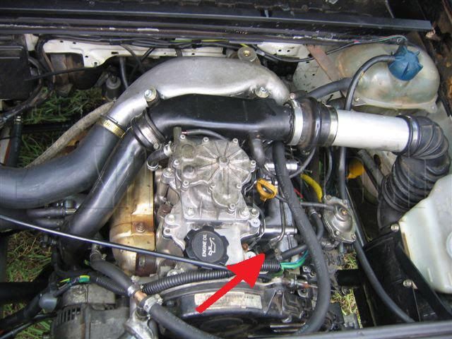

Postby evil_si » Mon Aug 15, 2011 7:59 pm
No
to bleed diesel injectors crack the fuel lines at the injectors
the 17mm (iirc) nut on the fuel line from the pump to the injectors (see pic below)
crack each nut approx 1/2 a turn at each injector and crank the engine
fuel should spurt out
tighten then try and start
