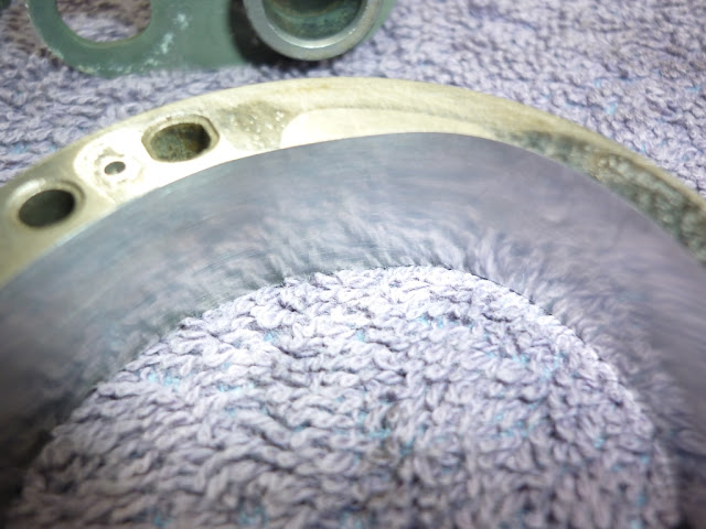

Postby mikeBrotherd » Mon Mar 07, 2011 8:50 pm
damn that was a long night.
Pulled the unit out and stripped the parts to see if kit matched and worth repairing
Kit matched and the pump looked like it was serviceable. Clean all parts in kero wash bay and wet-n-dry'd the cam ring to take out any lite scours. (had already replaced main bearing & seal in these pics)
Next was to reassemble the unit with the new seals as toyota intended. I followed a PDF i found on a forum, makes this part easy. PDF is listed for 2jz power steer pump/rack/column but is the same unit used on many toyota's.
Link to PDF > http://www.turbosupras.com/pdfs/JZA80%20TSRM/SR.pdf
Refit pump and follow PDF instructions to bleed and try out the new pump. I made a dumb mistake of reassembling my flow control valve with the spring and the valve the opposite way round, caused the pump to do nothing below 3k rpm and then all of a sudden make the steering feel so lite it was dangerous. Didn't have to pull the pump of to swap them back round. After correcting steering feels improved and makes the car feel more stable on the road.
