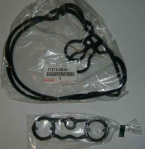

3) Scrape off the old gasket & clean the rocker cover. Is it safe to use a solvent to disolve any further reminance of the gasket? What's the best way to scrape off the gasket too (flat head again or is should I buy some sort of scraper)?
It'll be a rubber seal, just pull it out of the slot in the cover and drop it into the bin. Will look a bit like this
Pick the bits of RTV in the corners off then clean with thinners etc to get the surfaces nice and clean so the next lot of RTV sticks properly
