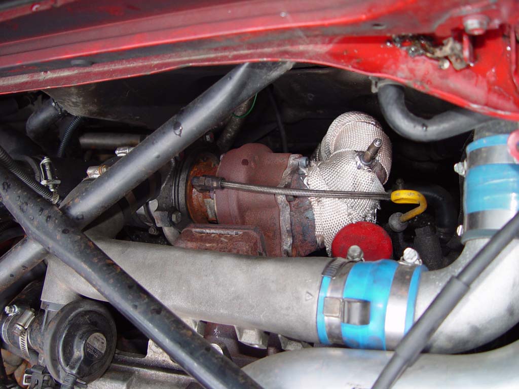

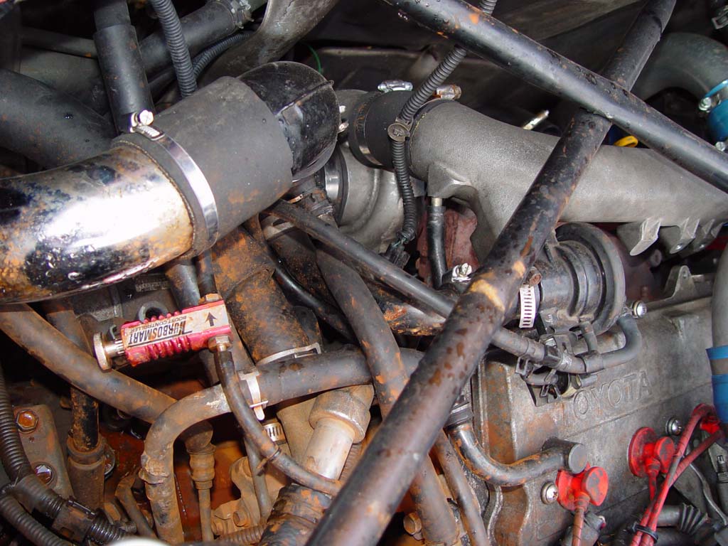

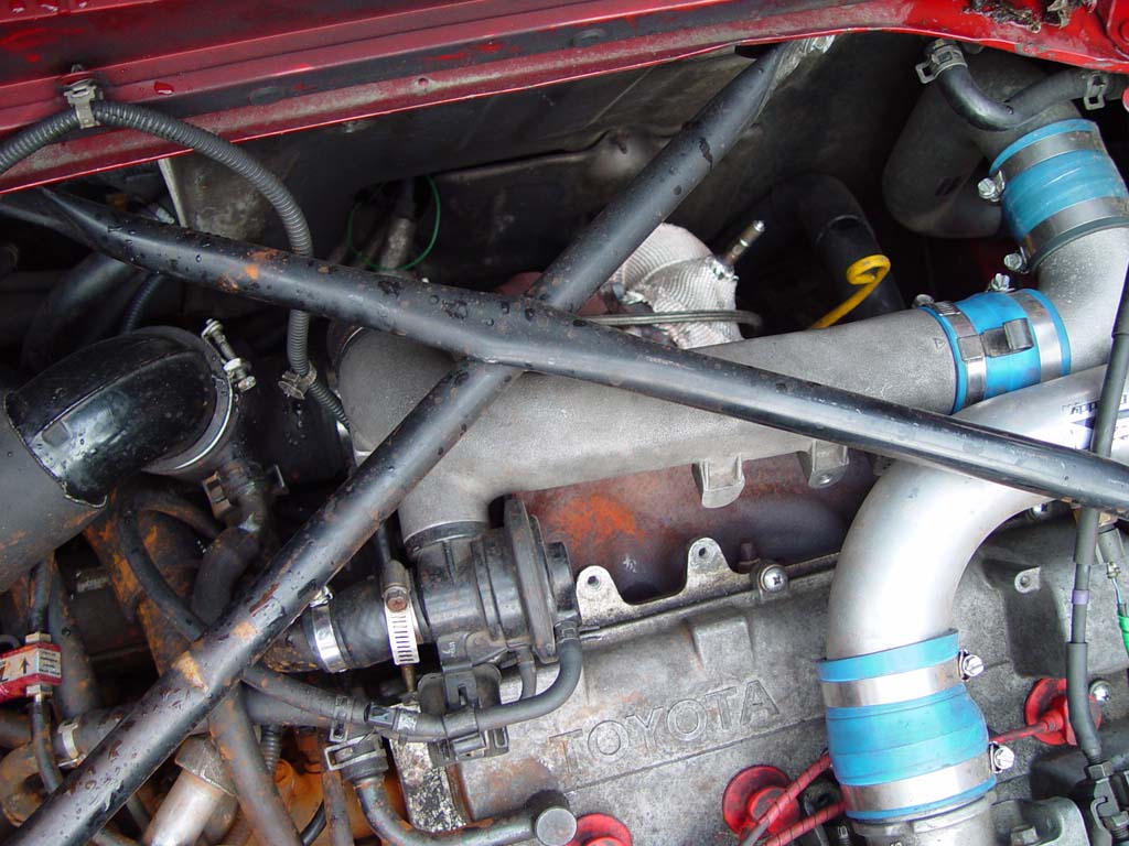

Postby Akane » Thu Apr 12, 2007 1:59 am
Same flange bolt pattern, the GE and GTE heads are almost identical.
I'm 99% certain the intake manifolds are the same.
Click:
http://www.lol.co.nz/temp/DSC04404.JPG
http://www.lol.co.nz/temp/DSC04405.JPG
http://www.lol.co.nz/temp/DSC04407.JPG
For RWDness you should keep the factory 3S-GTE exhaust manifold (It sits approx #3 to #4 which is good - brings the turbo forward), using a 3S-GE intake manifold and swap ends (hack and weld), if you're not keen on hack and weld then just keep the 3S-GTE intake manifold and do a RB20DET style intake.

Postby Akane » Thu Apr 12, 2007 5:33 pm
It shouldn't hit the bonnet because how it's mounted on an angle, ofcourse there are people who mount it straight, then you'll need to think about a custom intake.
There are 7 stud and 9 stud turbo manifolds, the 7 stud are the early revision one (shown by boosted 162), i have the later revision 9 stud manifold, they're both interchangeable between both revisions's head and manifolds, just that you'll end up not bolting up the last 2 stud holes.

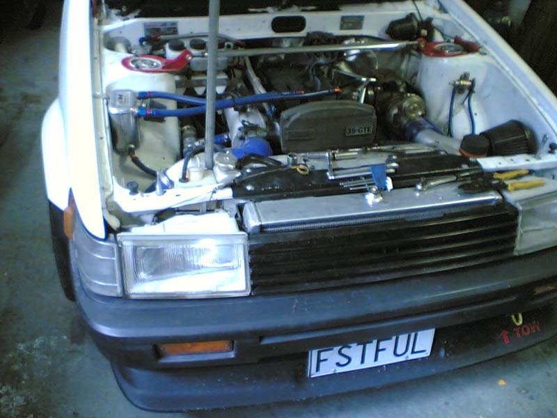

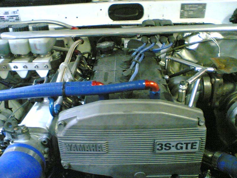

Postby KE25-KP30 » Sun Apr 15, 2007 12:59 am
Wow, they do say a picture beats 1000 words!!!
That's awesome Boosted_162, thanks a tonne, much appreciated.
Nice looking 86 there. Is that an earlier 3S? It seems, from what I've read/heard, it's best to leave them on the original angle or you have issues with oil not draining from the head, and problems with running bearings etc. Also, from the looks of it here, you can use the original intake and exhaust with the lean, and i think also original sump- which makes things a whole lot easier!!

Postby Akane » Wed Apr 18, 2007 9:04 am
That's an Altezza 3S, which you should lean towards if you plan to go FR, everything is in the right place and it's a lot easier.
Postby KE25-KP30 » Wed Apr 18, 2007 12:06 pm
I know the inlet manifold looks like an Altezza one, but i dont think the cam cover looks like one.... More like a 3S-GTE with an Altezza Manifold on it?? Don't know....
