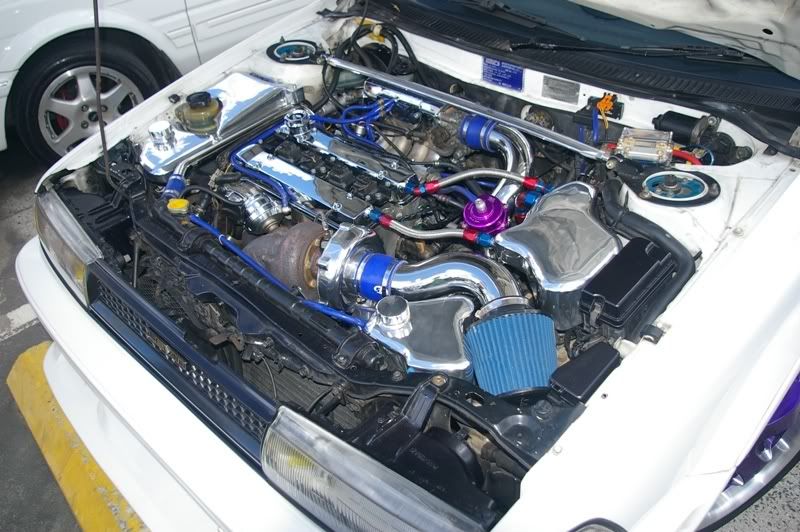

Postby escortman » Mon Oct 08, 2007 6:25 pm
Shot with EX-Z60 at 2007-09-23
Shot with EX-Z60 at 2007-09-18
mine fits with ae92 radiator
4x4 toyota blizzard offroader
escortman
Posts: 1651

Postby escortman » Mon Oct 08, 2007 10:33 pm
yeh with mine i can fit a filter but the sandwich plate for oil cooler puts it out 2far
escortman
