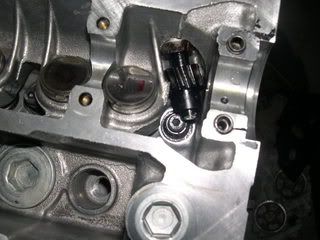

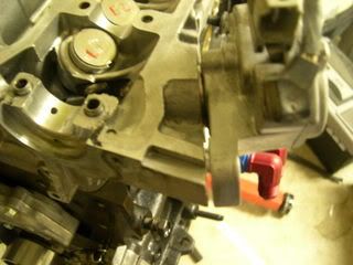

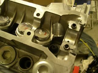

ive run into this issue im hoping some knowledgable people may be able to help me with.
as i slide the CAS into its port it is just fouling on the head stud below it.
here are some pictures:
sorry about the image size i cant get the resize thingy to work
the head is torqued down to 60ft/lbs and i have used the ARP moly lube.
ive sort of run out of ideas, so any help or suggestions to why this is occuring would be greatly received.
hopefully its something simple

yeh. the bolts were upside down in last thread i think. but look to be right way in those pics.
i'd say the bolts have not been wound down into the block enough, before you put head on and torqued up.

im sure they are right down. i put a ruler on top of them and all 4 exhaust studs are level, and the "problem" stud was atleast 6-8mm lower. :?
so im guessing it is supposed to be sitting lower than the other 4.
Postby QikStarlie » Tue Apr 08, 2008 10:10 pm
dont remember mine being lower, but could have been. if it can't go down futher, you'l just have to pull the stud out and trim the end off.

Postby 4agtepwr » Tue Apr 08, 2008 10:13 pm
mine was exactly the same, I shortend the cas shaft so it would clear

Postby TRD_ZERO » Wed Apr 09, 2008 10:19 am
ID say grind the cas as 4agtepwr said i wouldnt want to hinder the structural integrity of the stud.
TRD_ZERO
Posts: 1077
Location: Howick
Postby bluemaumau » Wed Apr 09, 2008 11:01 am
yea i understandd that, but CAS's are expensive and spinning pretty fast, wouldnt want to unbalance it
Postby slighty_sykotic » Wed Apr 09, 2008 11:17 am
I really doubt you would, just grind it flat across, then you can't hurt it.

true, wouldnt be too bad if i just cut a angled fillet of the stud tho would it?
thanks for everyones help btw
Postby slighty_sykotic » Wed Apr 09, 2008 12:45 pm
Not until you tried to undone it in a years time, after it has seized in place...
And the stud cracks across where u weakened it.
