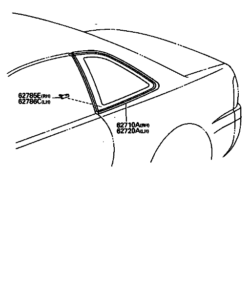

I have a guy picking this up tonight, so need to remove for car,
Is there anything I need to look out for when removing the glass, as from the looks of this diagram, there is just a clip/fastener and the glass just slots into place.
Steve

Postby andyztouring » Wed Apr 15, 2009 7:53 pm
They are glued in,cut them out from the inside(remove interior panels first),mouldings etc are fitted into the glass first then bonded(glued) into the window opening.

Postby jakesae101 » Wed Apr 15, 2009 10:19 pm
there is a special tool if its glued in like windscreens thin wire used as a saw

Postby Stott69 » Wed Apr 15, 2009 10:55 pm
A good sharp craft knife will cut the black sealant stuff, might take a bit, but patients may be needed.

Postby xsspeed » Thu Apr 16, 2009 10:03 am
Lol actually thought of cutting the metal around the glass, but at this stage I am trying to avoid cutting the car, incase I can sell the shell to someone
I will go the craft knife route, always have success with windscreens this way (except for new ones)
Never had much luck with the wire and cork style 'saw'
Postby xsspeed » Sat Apr 18, 2009 2:16 pm
Well, that was a b*tch
Broke it

Postby xsspeed » Sat Apr 18, 2009 3:21 pm
BZG|Bling wrote:Guts :(
Using the knife method?
Yeah thought I had it started to pry it a little bit and SMASH, spent a good 40 mins cutting it too.
