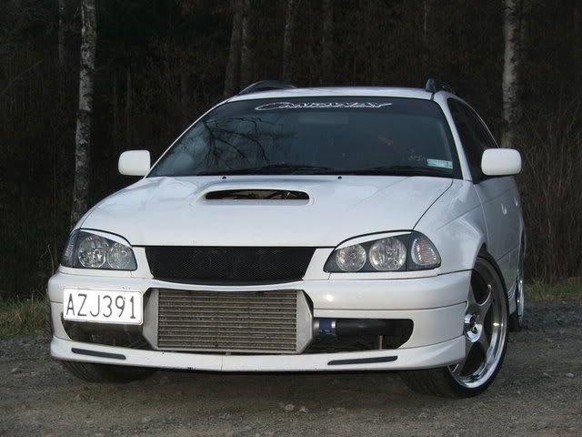

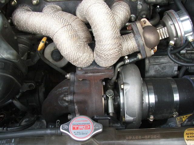

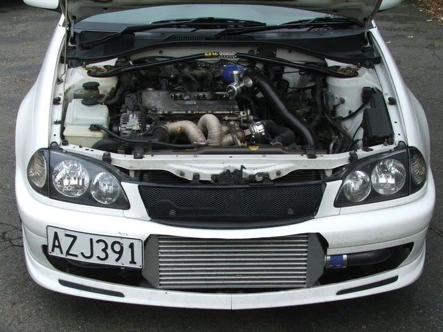

Postby WCKWGN » Thu Jan 03, 2008 1:06 pm
Driven performance now has a manifold for the caldina if you want to change your turbo as well. As Flygt4 said inverting the turbo is the way to do it easier and take out a couple of bends in the piping in doing so as well but only applicable on a aftermarket hair dryer setup.
here are some pics of how mine is setup which maybe handy
