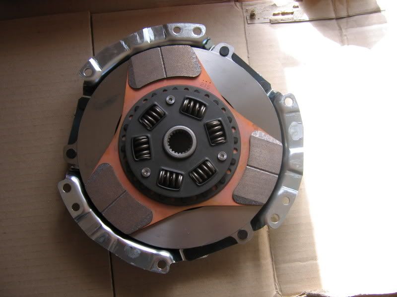

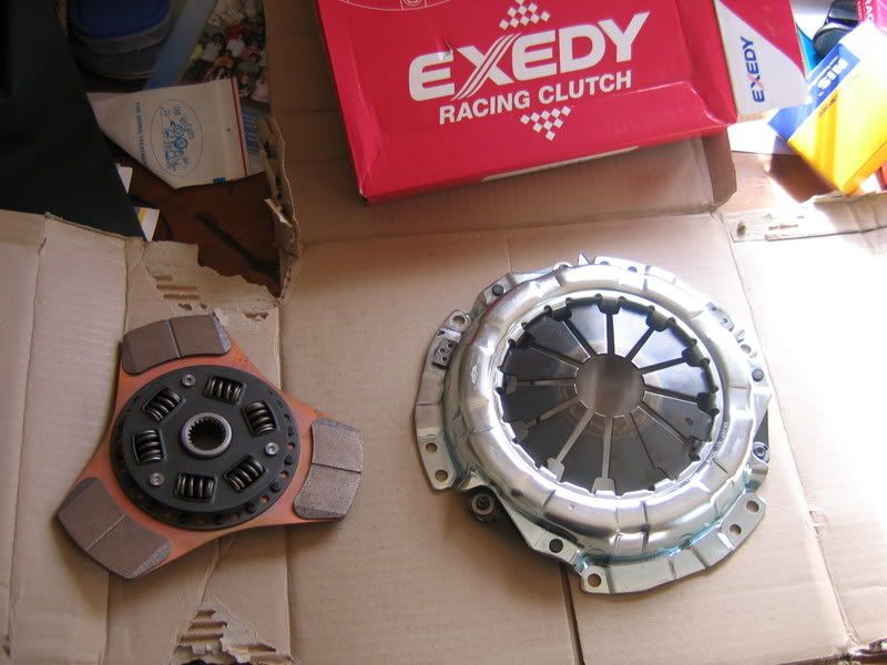

here the one I got...
3 puk with 3000lb pressure plate
Heaviest one I could get without going twin plate. Cost about 600-700?

Postby Stu- » Mon Apr 14, 2008 2:54 pm
Thats the bugger I'm after. What size flywheel are you using? Who did you get it through?

Postby no_8wire » Mon Apr 14, 2008 3:04 pm
212mm flywheel (this was a 4age clutch but fits on my 4afe flywheel)
Cant remember where I got it, ring Partsmaster in Henderson as they recommended the place I ended up getting it from. Just tell them what sort of HP etc you want to be running.

Postby themaleman » Mon Apr 14, 2008 5:22 pm
thats the same as mine, pity i never souced it myself

Postby IH8TEC » Mon Apr 14, 2008 7:23 pm
i'd love to see that actually pressure tested at 3000lbs
Postby Bazda » Mon Apr 14, 2008 8:28 pm
yea same here, I dont think you can ever get a 3000lbs in 212mm and also in the 4agze 225mm, the most I could ever get was around 2000lbs. Due to the design of the pressure plates.

Postby IH8TEC » Mon Apr 14, 2008 8:47 pm
and also note the design of that last pressure plate is alot different to the one you have shown that most of us run, hence the higher clamp pressure,
Postby no_8wire » Mon Apr 14, 2008 9:44 pm
Bazda wrote:yea same here, I dont think you can ever get a 3000lbs in 212mm and also in the 4agze 225mm, the most I could ever get was around 2000lbs. Due to the design of the pressure plates.
mmm I just going off what I asked for and what the guy told me he had in stock. Said on the box 1300kg = 2870lb roughly 3000lbs
Any place you can take them to get it tested?
