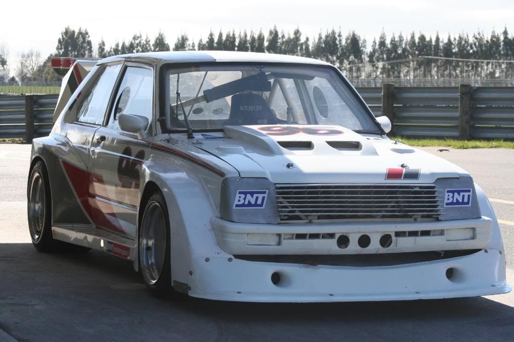

There is a V8 Starlet in the lower Nth island somewhere, I saw it once when I was at manfield. He never opened the bonnet where I could see so I dunno what kind of V8 is was. The Starlet was kermit green and extra extra wide with some HUGE slicks on it.
OOOOH Look I have a photo! Image

Think Iv seen this car too, and if i can remember correctly and going by the logo infront of the bonnet I'd say its a chevy in there

most of the nz supersedans were chevs they now have a few more a ae86 levin with a 1uz the powerbuilt mustang is a cossie v8 an rb powerd ceffy and datsun and the twin turbo f40 kit car but yes that starlet is a 350 chev http://www.nzsupersedans.com/html/warren_lauder.html i hvae met quite a few of the super sedan guys when i was a spanner hand for a guy who races one a few years back they all seem pretty cool they have some nice rides
