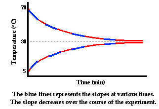

Postby sergei » Tue Jan 08, 2013 9:42 am
Grrrrrrr! wrote:
nz_climber wrote:Faster water flow through the radiator core will not always be better, there needs to be time for the heat transfer to occur.
Maybe something to consider.. (not sure on the exact figures so happy to be proven wrong)
Thats just another internet myth.
Not quite a myth. In every heat transfer there is a time factor. How fast the heat is transferred is dictated by temperature difference. It will cool faster if it is hotter, it will heat faster if it is colder.
http://www.physicsclassroom.com/class/thermalP/u18l1f.cfm
So theoretically having too much flow will increase average temperature.
Postby Grrrrrrr! » Tue Jan 08, 2013 10:08 am
Correct, the rate of heat tranfers is dictated by the temperature difference which is why more mass flow wins every time. More mass flow means you are pushing the water that has already cooled away from the face of the heat exchanger and replacing it with warmer water, therefore it is more efficient.
That graph is irrelevant, thats for heat transfer between two masses in a closed system. Not relevant to an open system with net energy changes.
Go to this website and play with the calculator. Setup some numbers, then double one of the flow rates... result is more heat transfer, everytime.
Grrrrrrr!
Posts: 2566
Location: Souf Orkland
Postby sergei » Tue Jan 08, 2013 10:35 am
Grrrrrrr! wrote:Correct, the rate of heat tranfers is dictated by the temperature difference which is why more mass flow wins every time. More mass flow means you are pushing the water that has already cooled away from the face of the heat exchanger and replacing it with warmer water, therefore it is more efficient.
That calculator is irrelevant as all it probably does is fudges the data into the preset calculations. Without seeing the source of the calculator (and formulae they used to calculate). I have no trust in the programmers ;).
