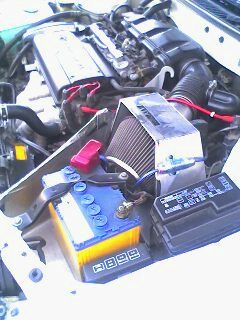

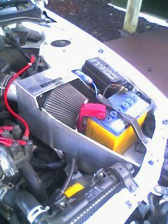

Cold air induction: Depends what you want to do. If your car has the standard air intake system, then just replacing the panel filter with a K&N panel filter would be the way to go. Or you can get rid of the whole standard unit and put in a pod filter, say K&N, HKS etc. There's been alot of talk in these forums bout which type is best but I say its up to you what you get. Then get a cold air box built and fitted. You could pay some guy at a performance shop to do it, or if you are pretty good at building things, buy some aluminuim from a engineering shop and build it yourself. I built my unit, its not exactly pretty but it works really well. After that fitted some ducting pipe to the new airbox. easy as. If I get a chance I will take a pic of my setup and post it up here, it works really well on cold nights, you can actually noticed a little power increase.

Postby bad20v » Thu May 26, 2005 5:32 pm
Here's couple of pics showing my filter and cold airbox setup:
http://i2.photobucket.com/albums/y49/ba ... NTAKE2.bmp
http://i2.photobucket.com/albums/y49/ba ... NTAKE1.bmp
Hope this helps.

bad20v wrote:Here's couple of pics showing my filter and cold airbox setup:
Hope this helps.
Thanks for that, have a sheet metal engineer whos a mate so i might be able to get it done through him :lol:
