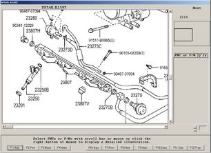

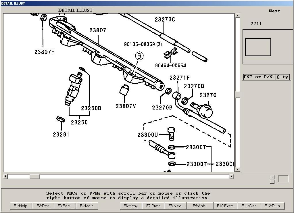

hey warwick, do you have pictures of parts of the engine from the EPC?
I would love to see the injector set up, especially since it's supposedly central injection (single point?)
also does it use the same one piece manifold/exhaust housing as the st215?

Postby Mr Revhead » Tue Dec 06, 2005 1:31 pm
single point? wtf are you smoking :P
they apear to have a longer injector, so maybe the moved the nozzle closer to the valve?
the heads are exactly the same part number.....
epc pics are not the best....
Postby Malcolm » Tue Dec 06, 2005 1:37 pm
weird, I wonder why they call it central injection then? I've seen it on a few websites.
the reason I wondered if it was single point injected is that 4S-Fi's were badged as "Central Injection" (or 16v Ci), and they had a single injector in the throttle body - I thought central injection must have meant it was injected in the middle of the airstream
maybe this motor has the injectors positioned so it injects right in the middle of the port or something??
also can you confirm whether it was vvt-i or not?
thanks :)
