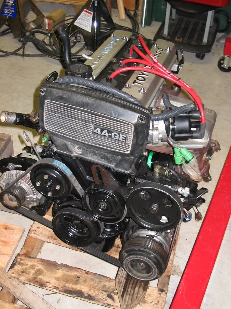

Ive stripped all the interior behind the front seats 8)
And bought a couple of gauges just to chuck in to keep an eye on things
Water temp and Oil pressure.
I can see where the sender is for the water temp,
But can someone show me where the sender is for where i would connect the Oil temp to.
can you see it on this pic?
Thanks, (pics of interior soo)

Postby Xyrath 86 » Fri Feb 24, 2006 9:00 pm
Its a little round thing next to the oil filter behind all the powersteering/air con shit on my engine.

Postby KinLoud » Fri Feb 24, 2006 11:14 pm
Oil pressure or oil temp?
Oil pressure - In your pic... just below the distributor will be a pressure switch or pressure sender screwed (depends a bit on what car it came out of) into the block, there will be a terminal on it to connect to the oil pressure light or oil pressure gauge.
Oil temperature - No 4age powered cars came out with oil temp gauge as factory.

Postby samlloyd » Fri Feb 24, 2006 11:48 pm
Thanks.
Its oil pressure kinloud.

Postby Caveman » Sat Feb 25, 2006 1:19 pm
Should be behind the ps pump under the distributor 8)
