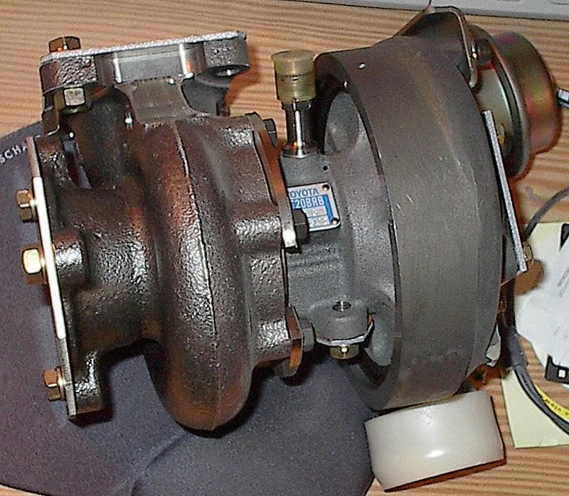

Postby Phothog » Thu Dec 21, 2006 5:11 pm
classique71 wrote:They didnt use the ct20B on the WRC car by memory but another rarer hybridisation
one of these turbo's was available in OZ recently - its still a CT variant but cannot recall the number
i nicked these off a auction on Ebay... a Brand new WRC Turbo
Phothog
Posts: 207
Joined: Sun Jul 10, 2005 12:29 pm

Phothog wrote:i nicked these off a auction on Ebay... a Brand new WRC Turbo
Does it come with the dodgey restrictor?
