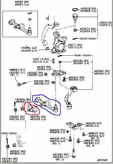

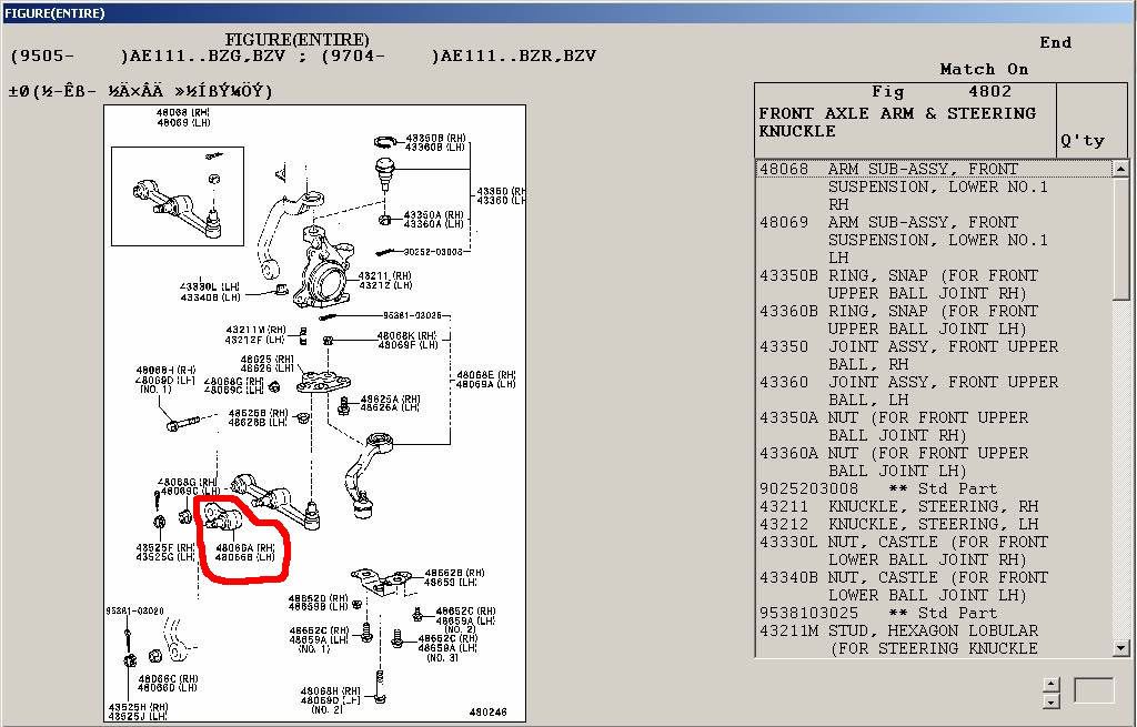

Postby spark_38 » Fri Aug 10, 2007 10:49 pm
I think it's the bit i've circled in red with two inner ball joints (according to a mechanic)
I have the same problem in my AE111 BZ-R levin, it started off as a squeeking sound - now the ball joint is worn out
Toyota have quoted me $244+GST for the part

Postby spark_38 » Fri Aug 17, 2007 9:18 pm
Changed the little piece over tonight relatively easy (using only a jack, some spanners and a few other tools)
Found out also it is the lower arm that the small piece (above in red) fits onto that's causing the sqeeking sound. so i suspect the ball joints in that are also on their way... anyone have a fair idea on the price of that part?

Postby spark_38 » Sun Aug 19, 2007 4:28 pm
just to confirm the control arm is the bit i've circled in blue.
the red piece is already been replaced
