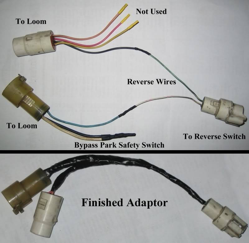

When I did this conversion on an AE82 I kept the Auto ECU and made up one of these.
The plugs on the left have been cut off the old auto box and plug straight into the existing loom.
The plug on the right was a spare on the loom that I think went to the fluid level indicator on the auto box, either way it wasn't needed so I used it for the reverse lights switch.
I'm assuming an AE101 will be similar.

Postby pc » Thu May 01, 2008 5:52 pm
Didn't my photo show that? :lol:

Postby 4-AGE 4-LIFE » Thu May 01, 2008 7:43 pm
yes your photo showed that, but it confused me :oops:
i just bypassed the switch at the ecu pins
