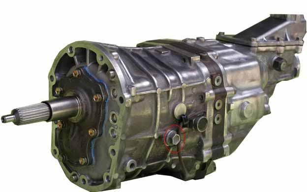

decided to change the gearbox fluid tonight i cant see the drain plug but where is the refill plug located and what does it look like? (the pictiures on the tsrm arnt very clear)
just wanted to double check i can refill it with no problems before i drain it. as it my daily driver at the moment 8O

Postby Jason T » Wed Aug 27, 2008 12:24 pm
Left side of the box at half way mark just in front of reverse light sensor
That bolt is fn tight careful not to round power bar with a jack makes it easy
Take out the stick and fill from there
Check the bushing the stick sits on and at the end of the the stick at the same time
