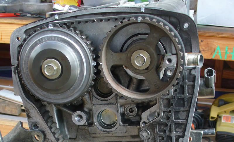

Postby 85AW20v » Sun Sep 07, 2008 1:58 am
Be careful timing up the 20v. On one of the pulleys - I'm sure its the exhaust - there are two marks and it's easy to get the exhaust wrong. You need to look down the oil filler hole to make sure the inlet is right - there's a dimple that you should be able to see when the crank is at TDC. It lines up with the flat plate that comes halfway across the filler hole. You'll see what I mean when you have a look.

Postby matt dunn » Sun Sep 07, 2008 10:44 pm
Simon85MR220v wrote:Be careful timing up the 20v. On one of the pulleys - I'm sure its the exhaust - there are two marks and it's easy to get the exhaust wrong. You need to look down the oil filler hole to make sure the inlet is right - there's a dimple that you should be able to see when the crank is at TDC. It lines up with the flat plate that comes halfway across the filler hole. You'll see what I mean when you have a look.
Actually both the cam wheels have two marks,
one has two dimples and one has a dimple and a line.
They should line up at TDC with two dimples at the top,
and then the other dimple and the line should line up with each other in the centre of the head.
Postby deaf_rattle » Sun Sep 07, 2008 10:48 pm
anyone got pics? to make sure what ive done is right.
Postby matt dunn » Sun Sep 07, 2008 11:00 pm
Try this picture,
