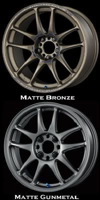

Postby TRD_ZERO » Sun Sep 07, 2008 12:01 pm
Im looking at getting some wheels at some stage but just doing a little research before hand. Im wanting to know about these wheels as you can see by the pic the top one where it is bolted to the hub is alot more recessed than the one on the bottom. Why is that? I like the ones at the top but the ones at the bottom look completly different with the center bit sittling out alot further. Has it got to do with offset?
Wheels size? As i remember it was a similar issue with those dtm gt30's when they were in 17s the face was rather flat but in 18's the center is recessed.
Id be wanting to get a set of the ones in the pic at the top for my ae111 or would something like offset or whatever else make me have to get the ones at the bottom?
Thanks all input appreciated.

Postby Boosted_162 » Sun Sep 07, 2008 12:17 pm
Its to do with offset and width. Take a look at the wheels on my Lexus, the fronts are 17x8, with a +30ish offset? (assuming here) and the rears are 17x9 with a +15 offset. They are the same wheel, just look quite different.

Postby TRD_ZERO » Sun Sep 07, 2008 12:38 pm
Oh ok sot the picture in the top has a negative offset and the one in the bottom has a positive one then? Im guessing ae111 wont be able to fit a negative type one and id have to get positive ones right? They look like two completly different mags just because of the offset.
What is the maximun negative offset a ae111 can run so i could get that recessed look.

Postby Boosted_162 » Sun Sep 07, 2008 12:44 pm
TRD_ZERO wrote:Oh ok sot the picture in the top has a negative offset and the one in the bottom has a positive one then? Im guessing ae111 wont be able to fit a negative type one and id have to get positive ones right? They look like two completly different mags just because of the offset.
You wont be able to run negative offset wheels on an AE111, they will stick out a lot! Standard offset is around +35 - +40 (thats a measurement in millimetres - a +20 wheel's hub sits 15mm closer to the inside lip than a +35 wheels hub)
The recessed ones dont have to be negative offset, mine are +15.

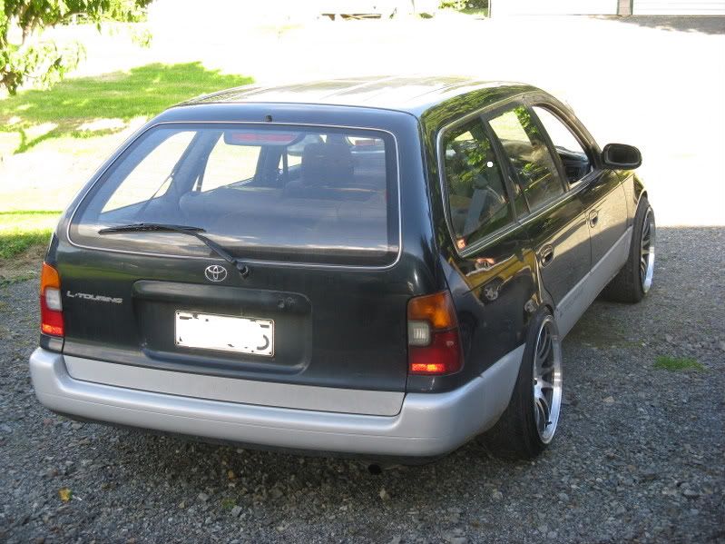

Oh, and check out soopachargen's wagon, afaik he has the same wheels as me (the rear ones) on his 101? wagon.

Postby Boosted_162 » Sun Sep 07, 2008 1:53 pm
Thats soopachargen's wagon. Same wheels as me, just different colour, and i run 8's on the front.

Postby soopachargen » Sun Sep 07, 2008 7:26 pm
Thats me!!! im e-famous!!
not all 205s will stretch onto a 9 inch rim easily, i got lucky and the ones i already had went on without even needing a gusher, it rides like ass and i've never even chanced taking them through a warrent but it gives the euro/vw look i was going for with silly stretch

Postby soopachargen » Sun Sep 07, 2008 7:47 pm
here's another photo after i gave it some more camber to tuck them more, it shows the concave of the wheels well
