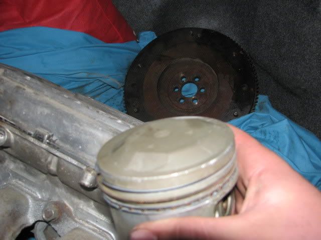

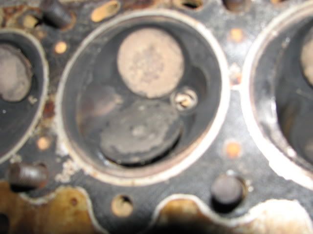

Postby fuel » Mon Jan 19, 2009 3:46 pm
how is the rebuild going anyway? got pics?
I'm pretty sure it was an 8.4:1 engine, it's the late model EFI which doesn't have hemi shaped combustion chamber and piston tops - it's the one which has an offset dome on the pistons (assuming you're still using the original pistons).

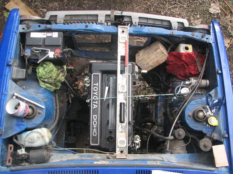

Postby 79rolla » Mon Jan 19, 2009 5:05 pm
its bult, been sitting for a bit over a yeair now
have mounts made just need small adjustments
just trying to sort out all the parts for the efi and turbo so i can start on that soon
pics as of when i first got it
and when i was making up the mounts
have pics of mounts aswell that are on my project page, just click on the picture in my sig
dont have any pics of the buld as i did that in a workshop in town,
