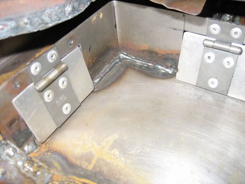

Postby deaf_rattle » Sat Jul 04, 2009 9:41 am
thats what i had done to mine.
wings for extra capacity and trap doors to stop too much sloshing around corners.
Postby Crucible » Sat Jul 04, 2009 5:49 pm
deaf_rattle wrote: Image
thats a good idea with the hinges!, never seen that before

I don't really see how that sump would stop oil surge. Having the hinges there... its just like not having the wings on the side, its mainly for more oil so it can just recirculate back around in the sump.
But isnt the problem oil surge? you need horizontal baffles to stop that.
At present if you turn a long corner hard the oil will just ride up the side of the sump, or backwards etc.
Postby deaf_rattle » Wed Jul 08, 2009 3:49 pm
the wings and hinges are there to make sure there is plenty of oil around the oil pick up at all times, around corners especially.
Postby Bazda » Wed Jul 08, 2009 4:10 pm
deaf_rattle wrote:the wings and hinges are there to make sure there is plenty of oil around the oil pick up at all times, around corners especially.
It needs some sort of covered section, hard to explain lol
Postby deaf_rattle » Wed Jul 08, 2009 4:23 pm
maybe if you roll the car, but i dont plan on doing that.
if i do, oil will probably be the least of my worries.
i know what you mean and i did think about that. could always put something in like that later, but i dont think thats as important as extra capacity and the hinges we have put in.
