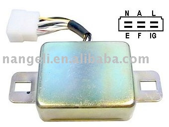

Postby cat007 » Thu Oct 07, 2010 11:39 am
Also I should point out that the old voltage regulator looked like this:
The new one, however, doesn't have the big bit on the top (which appears to be a giant relay) and looks like this (although it's in a plastic case, not metal):
I'm guessing it's different because it's newer and we have better solid state tech than we did back in 1987?

Postby cat007 » Tue Nov 09, 2010 4:12 pm
matt dunn wrote:Been a while since I did much with the old externals,
but I would have expected only one power fed to the alt in that 3 pin plug.
Are you sure the reg is the right one as there about 6 different versions that all look identical.
I'm pretty sure it's the right one. Unfortunately I have intelligently lost the receipt. It's not a toyota part but is supposed to be a 'match'.
I'll check everything either later tonight or tomorrow evening when I get a chance and get all the model numbers etc.
It does seem very odd that I'm getting +12v on 2 of the pins and 6 on one. Maybe I should test what voltage, if any, I'm getting on those same pins without the regulator plugged in...
