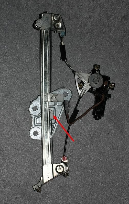

The same sort of thing happened to my Corolla a while ago when I slammed the driver's door really hard. The window would go down, but not back up. Discovered that there's a little plastic piece that's attached to the wire which pulls the window up that had snapped off when I slammed the door. Ended up replacing the whole regulator and it worked perfectly again. Sent a driver's regulator overseas once too and noticed that it had tiny hairline cracks on that plastic piece, so they must get stressed over the years of constant door shutting. Not sure if the Nissan's have the same set-up, but that's what happened to mine.

Postby Kiwi-Corolla » Mon Aug 22, 2011 5:35 pm
Yep, that sounds right. The little plastic piece hooks behind the track and renders the wire useless when it snaps off. I managed to find a photo I took when I sent a regulator the same as mine overseas, which shows that little plastic piece:

Postby .:O4AGTZ:. » Mon Aug 22, 2011 5:52 pm
That pic was really useful thanks! The basic principle seems to be what I expected and the same on yours pretty much as the pulsar. Except on the pulsar the wire runs up the middle of the track as opposed to next to it. Something has definately broke that connects the part attached to the window to the the wire.
