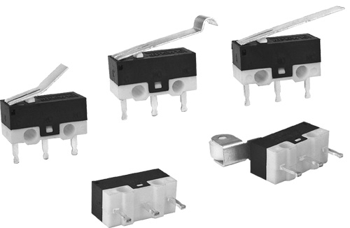

Postby Dell'Orto » Tue May 22, 2012 8:08 pm
You've tried this type?
Both Jaycar and Dick Smith do various versions of these
Postby Bazda » Wed May 23, 2012 9:21 am
Dell'Orto wrote:You've tried this type?
That wont work, not enough travel.
