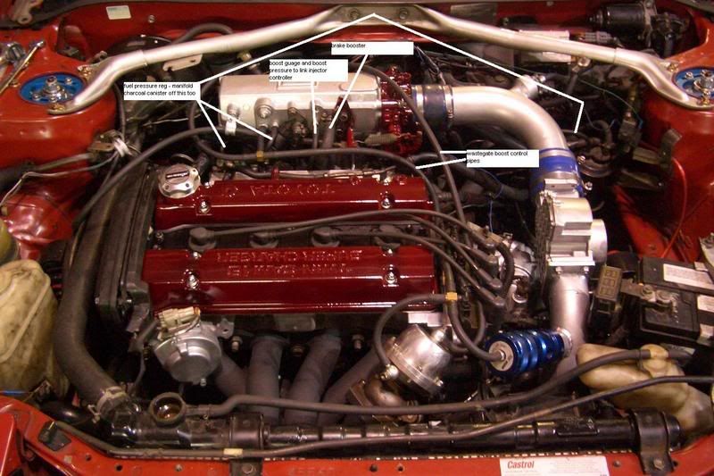

ok, now my motor is freshly built up, timing etc al set up properly, but i only get -8vac on my boost guage, when engine breaking it goes to -9, but wont go any further, anyone got any suggestions as to why this could be, i dont have any leaks of anything.
any suggestions, got me puzzled :?

it's coming straight off the manifold. if you look closely you can see what i've written. i hate paint and can't edit the size of font

i dont have any of those vsv things hooked up, no a/c idle cause i dont have aircon. all i have is whats labelled in that pic, sorry i know it's hard to see

Are you running the brake booster off the old oil breather pipe? If so not a good idea. The oil breather pipe goes before the throttle body which means off throttle theres no vacum getting to the brakes. Its supposed to run on vacum on throttle off (after the throttle body). If you have modified the old oil breather line to go into the manifold disregaurd what I said :D
Another thing I noticed, you have the petrol breather going after the throttle body :? Put it before the throttle body as it is from factory.

1998 wrote:Are you running the brake booster off the old oil breather pipe? If so not a good idea. The oil breather pipe goes before the throttle body which means off throttle theres no vacum getting to the brakes. Its supposed to run on vacum on throttle off (after the throttle body). If you have modified the old oil breather line to go into the manifold disregaurd what I said :D
disregarded :lol:
umm, good point abotu the petrol breather one, wasnt' too sure which side it was meant to go on. will try that, thanks.

dylan, i owe you a beer mate, turned out to be that line going from charcoal canister, i now have -16 just from a quick start from cold.
thanks :lol:

michael, yeah it's that guage, fixed the vaccum problem, and guage reads accurate now aye, i have a 6psi wastegate spring and if i turn boost controller right down it shows 6psi :)
