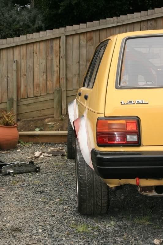

Postby Burning Angel » Sun Oct 19, 2008 8:22 pm
i used a corona diff(t series) which is about 100mm wider total, so 50mm each side. you can get away with it if you use front wheel drive offset wheels like +35 or more.
i am running 15x7 +8 so i had to go with big flares:
i also run gx60 struts in the front but thats alot of f&*king around and i would not recommend it.[/img]
