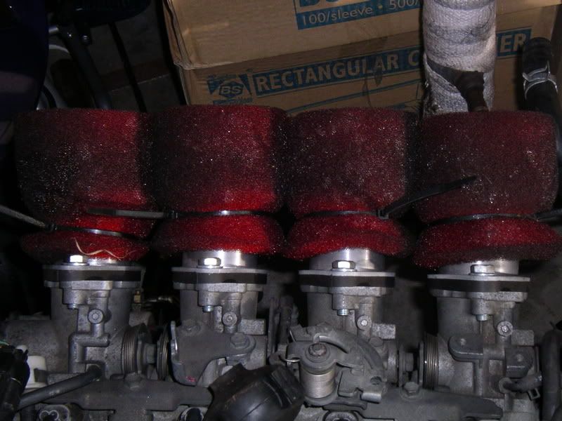

Postby gasman » Tue Jul 31, 2007 9:18 pm
Caribeena wrote:yeah i had mine off for a bit! insane! whered you get the filter sox from? i found some for $200 for 4, just want to see if theres any cheeper.
buy mine here
pics here
needs a bit of a clean and the zipties are even special ones where they have a tab to release them so you can use them again.

Postby gasman » Tue Jul 31, 2007 10:09 pm
Matty104 wrote:gasman,
do u reckon you could put a pic of the trumpets up without the filters on?
the engine is in wellington with my brother so ill tell him to take a pic of them asap.

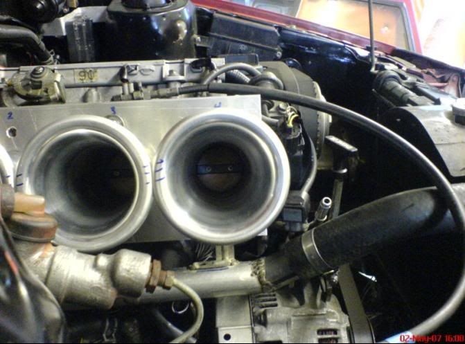

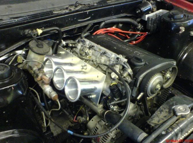

Postby Crampy » Wed Aug 01, 2007 11:21 am
Here's mine. No dyno plots or anything.
I think it would have been better having them in a big single box with a filter on the top and my bonnet scoop feeding it. I sold the car before getting any of this done though.
